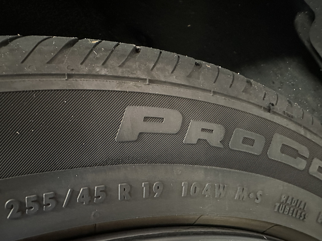

I know the Continentals that come on the 19" Gemini wheels are all season....I couldn’t really find any source to indicate MYLRs have summer tires as a factory option.
"Continental's Conti ProContact RX tires come branded with an M+S symbol, which stands for Mud and Snow. This means they can handle all weather conditions, so no matter what weather you find yourself in, the Conti ProContact RX can handle it."
