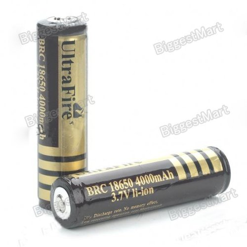

    (Those who want proof of the 4000 mAh cell can check this link: http://www.amazon.com/UltraFire-Prot.../dp/B006OHO9I2 where theyu're selling small packs with this cell, for use in flash-lights, lasers and such.
    So, it's inevitable that the packs will continue to evolve, and it would seem that Tesla has a good partner in Panasonic and I wouldn't expect them to switch, since Panasonic seem to be at the forefront of battery tech. The the question is how likely is it that once the Model X (and maybe also the Model S 2.0) is produced in another 1.5-2 years time will there be 4000 mAh (or even more) in each cell? If you switch out a 3100 mAh cell with a 4000 mAh cell rated at almost the same voltage it gives an aproximate 110 kW pack (disregarding any weight difference)!
    Those are "Ultrafire" cells, not Panasonic. Under 1A draw, those "4000mah" Ultrafire cells only measure less than 2000mah in capacity (less than half of claimed capacity). Panasonic cells on the other hand tend to measure at claimed capacity or very close:

    Quote Originally Posted by Johan View Post
    Yes, quite confusing when the just keep the same name (NCR18650) with every new version.
    I'm pretty sure he meant the name "UltraFire" for a Li-ion battery.
