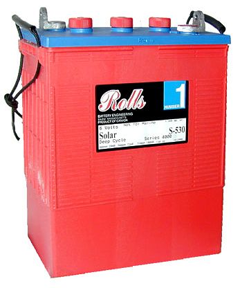

    I have 24 giant lead acid batteries

    I have 24 of these guys:
    They are 6 volt lead acid in 3 series of 8 (3 banks of 48V). Each are 2 or 3 times the size of a normal car battery and I think they weigh about 150 lbs a piece.
    There are two pieces of maintenance required. 1) because they are not sealed, you have to make sure they have enough liquid to cover the lead plates, and 2) every six months they need to be "equalized" where you pop the tops off, and flood the battery with a bunch of current for about 3 hours which boils the sulfuric acid and gets it everywhere (nasty).
    Because I use "water miser" caps, I only check the water levels when I do the equalization every 6 months instead of every month like I would if I kept the standard cap.
